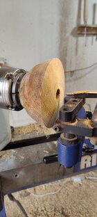

Turned the Tenon between centers. It’s flipped ready. My knee and back are not!
Annndd… dang it I scrapped my stinky leg as I stupidly walked. I swear. It’s bad enough with these tubes coming out of my nasty Kidneys!!
