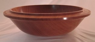

This is the wood I was talking about. Maybe the second/third bowl I made after mushrooms/snowmen. Still has a nice aroma on the unfinished bottom. Probably is the Spanish cedar which after reading the wood data base makes sense because I thought it might be some kind of mahogany.
Does look very close to African Mahogany.
