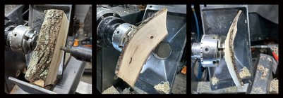

Got it wrestled onto my too small Nova lathe. Spins fine, was able to run it 350 rpm, fast enough to get nice cuts.
Didn't get far before running into a nail. (Also ripped a nail when working with chainsaw) So, not so surprised and reasonably confident that I won’t have nails in the finished piece.637BE3BC-DEE4-4277-BB5A-850E5513CA2D.jpeg
Looking good Marc. The nail is frustrating. I just acquired some walnut and hit two nails when chainsawing my blanks. About 5 minutes after I had just sharpened my chain :(
