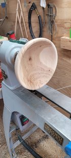

A plain ash dog dish that has been kicking my butt!
I couldn't get rid of the tear out so I gave up and sanded till that got tiring. I must have sharpened 4 times both 1/2 and 5/8 gouge.
Best I've come up with if someone asks about the marks is "It's emerald ash borer marks" It's my story and I'm sticking with it.
